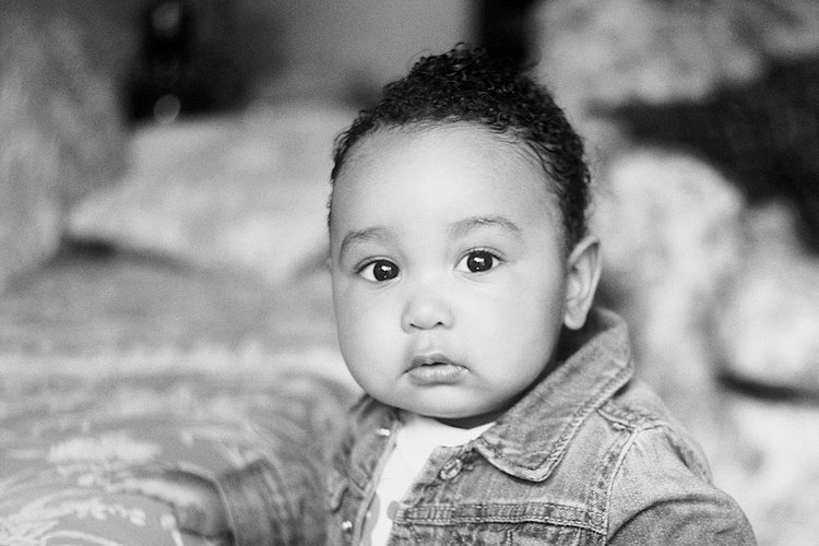

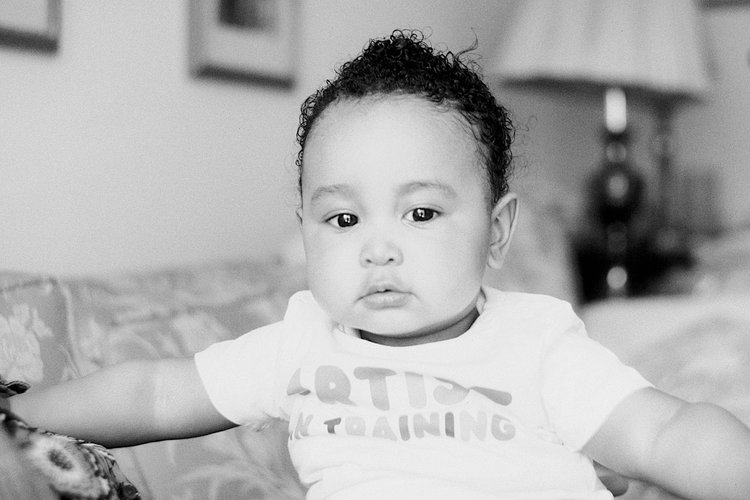

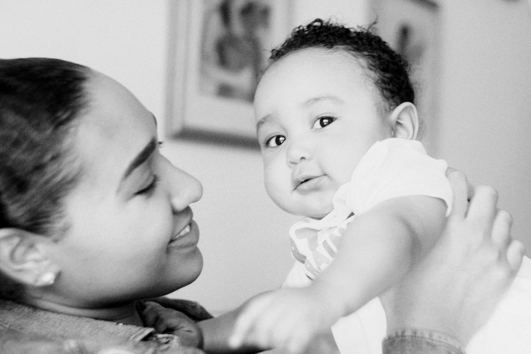

I decided to give it a shot. My grandson and daughter, HP5 @ ISO 800, Zeiss Jena Biotar 58mm / Pentax SV.
These are very different from the type of b&w I normally do. I generally do very contrasty stuff. I learned b&w in the context of the zone system and I live in zones 1-5 and 9-10, skipping over those silvery light grays of zones 6-8. But these have those grays, without skimping on the lower tones. They have a pretty complete tonal range and somehow (maybe through confirmation bias) they retain much of the luminescence of the experience of viewing the images as slides, to my eyes.
