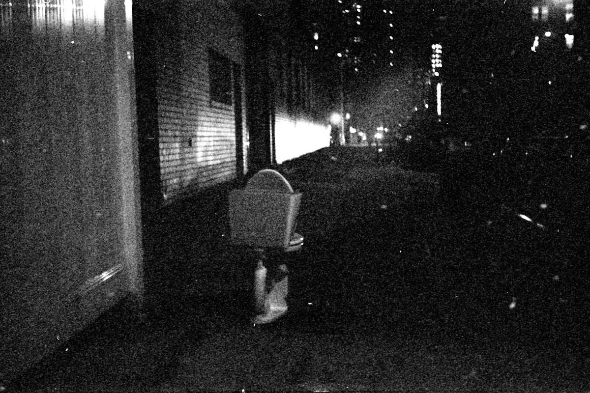

My initial prediction was that C41 +1.5 > HC110 stand > C41 normal. Boy was I wrong :o First off, the clear winner is, to my absolute shock and near horror, C41 NORMAL :o :o :o
(look at that shadow detail in this outdoor night shot! yes there was a decent light to camera left, but even the bumper on the right is decently exposed, for 1600...)

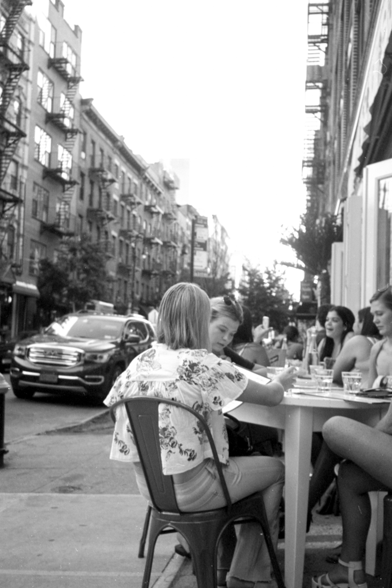

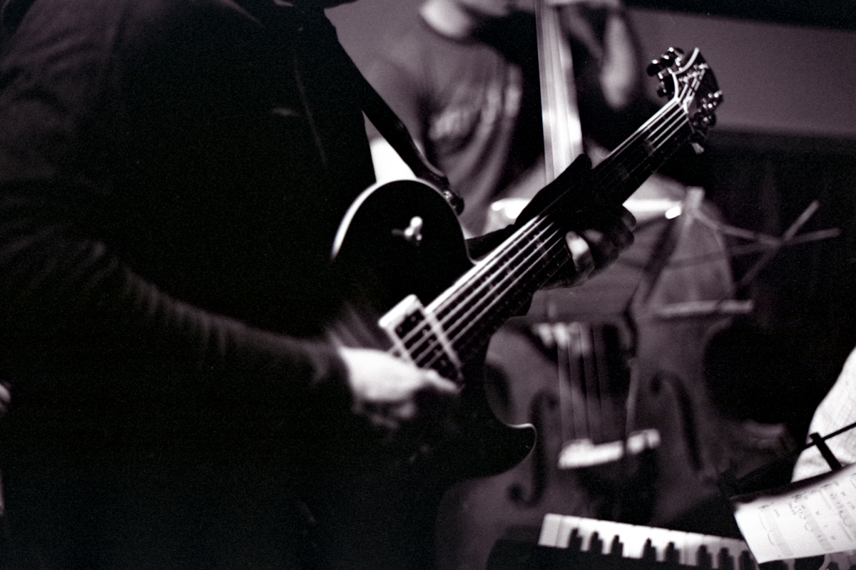

Next up, HC110 stand developing isn't that bad, as long as the lighting is decent. (Like the C41 shots, I scanned these as color, which is why the purplish base gives it some toning.)
(I don't know why I focused on her ass instead of her head. in any case, I did get her approval to post on social media, so apparently she doesn't mind)
What do you think? Not as much shadow detail as C41 normal, no?
This one's not bad, and it's pretty much close to what I'd expect from Tri-X under the same conditions.

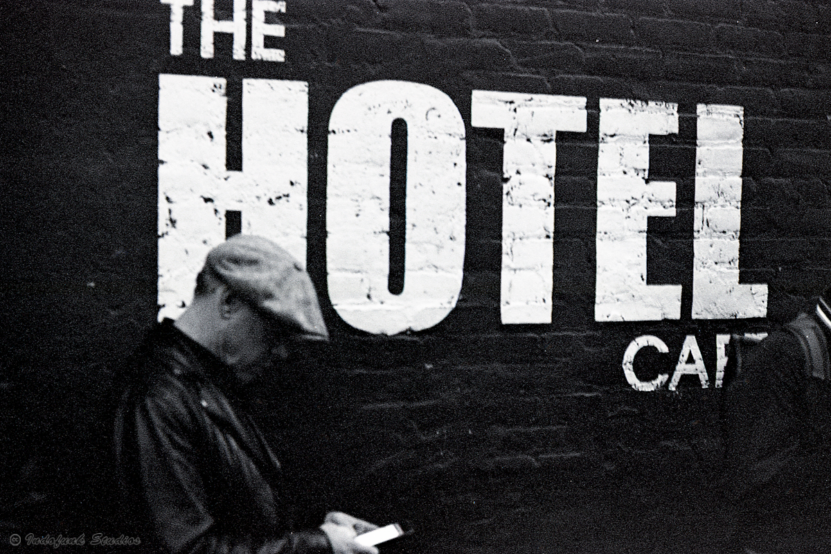

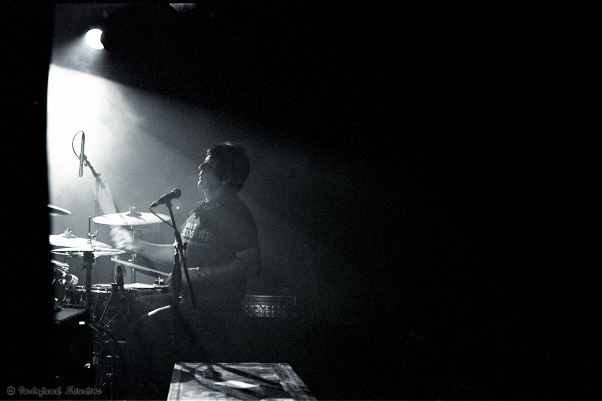

Last (and definitely least ::) ), C41 for 5 minutes. I expected this to be the best because of my experience with Gold, but it looks like XP2 doesn't have a very long tail. All the extra 1.5min in C41 did was to block up a lot of the highlights. No visible improvement in the shadows. Also, much grainier. I like some grain, not quite this much :D
(This is Clem Burke, the drummer from Blondie, playing with the band LAMF last week. The band I was playing in opened for LAMF on their short bicoastal tour.)

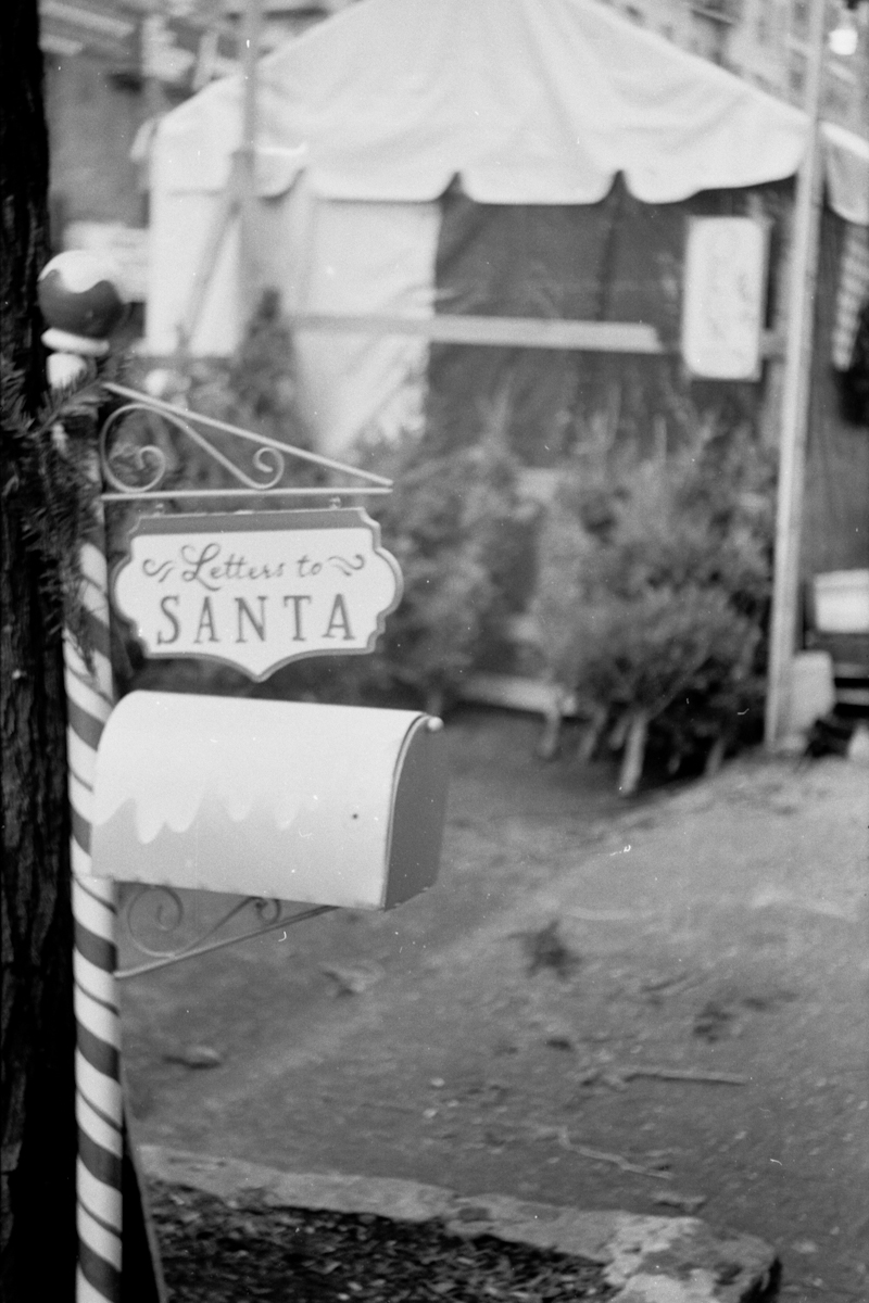

So I did it. I loaded up some XP2 in my Graflex Ciro 35 so that I'd have very little control over the exact exposure, and I shot *mostly* at f/5.6 and 1/100th. There were times when I pulled it out of my pocket, shot it, and looked at the settings and they had changed, and then for the darkest exposures, I opened up to f/3.5, but this wasn't a scientific test anyways ;D It was a "bring it, XP2" challenge :D
Here are some examples from what I *think* are highest EVs to lowest EVs. No idea what those EVs were though ;D All developed normally in C41.

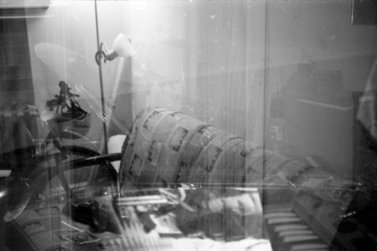

Here's a bonus multiple exposure of a few rooms in my apartment, which I like because it really conveys what a mess the place is :D

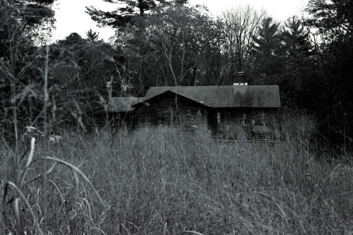

Ok, a new experiment with XP2. I was going to develop a roll of "semi-desert" Ektachrome in C41 for 2.5 minutes (roughly a one-stop pull? maybe 1.5? I don't know, I just know that it works with this particular batch of fogged Ektachrome 64T), so I decided to shoot a roll of XP2 @200 and include it in that one stop pull. Here are the results. Executive summary: XP2 continues to be magic. The 1 stop overexposure + 1 stop pull gave me beautiful negs, and the only negatives (hahaha I did that on purpose :-[ ) are that they seemed to be a bit lacking in contrast, and there was a lot of extra schmootz on them (though, I find that any time I process film not according to box instructions, I tend to get a lot of schmootz ... this includes underexposing and pushing, as well as overexposing and pulling). Being the egotistical fool I am, I upped the contrast in LR and removed as much schmootz as I could, but there's only so much contrast you can add back to negs, so I think you'll get the point.
All photos taken on my XA. Shot at 200ASA, developed in C41 for 2.5 min, normal blix.

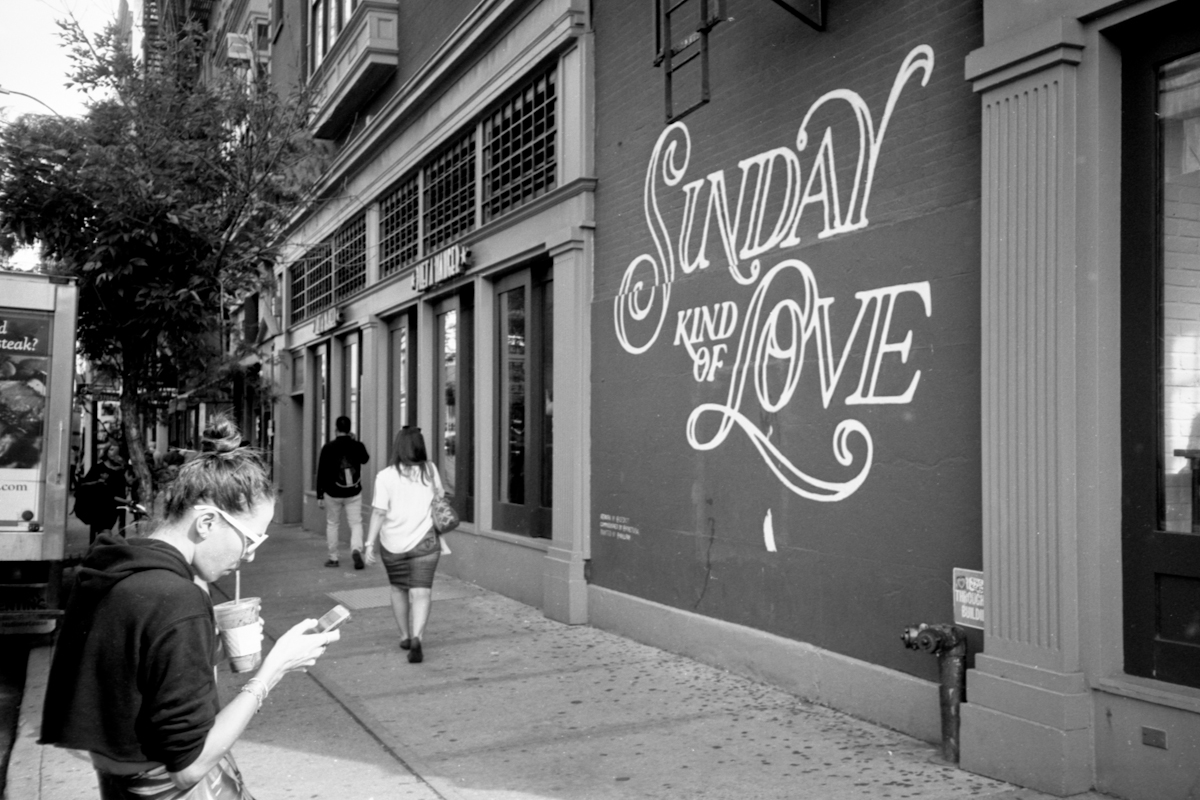

A Sunday kind of iced coffee and head-buried-in-cellphone

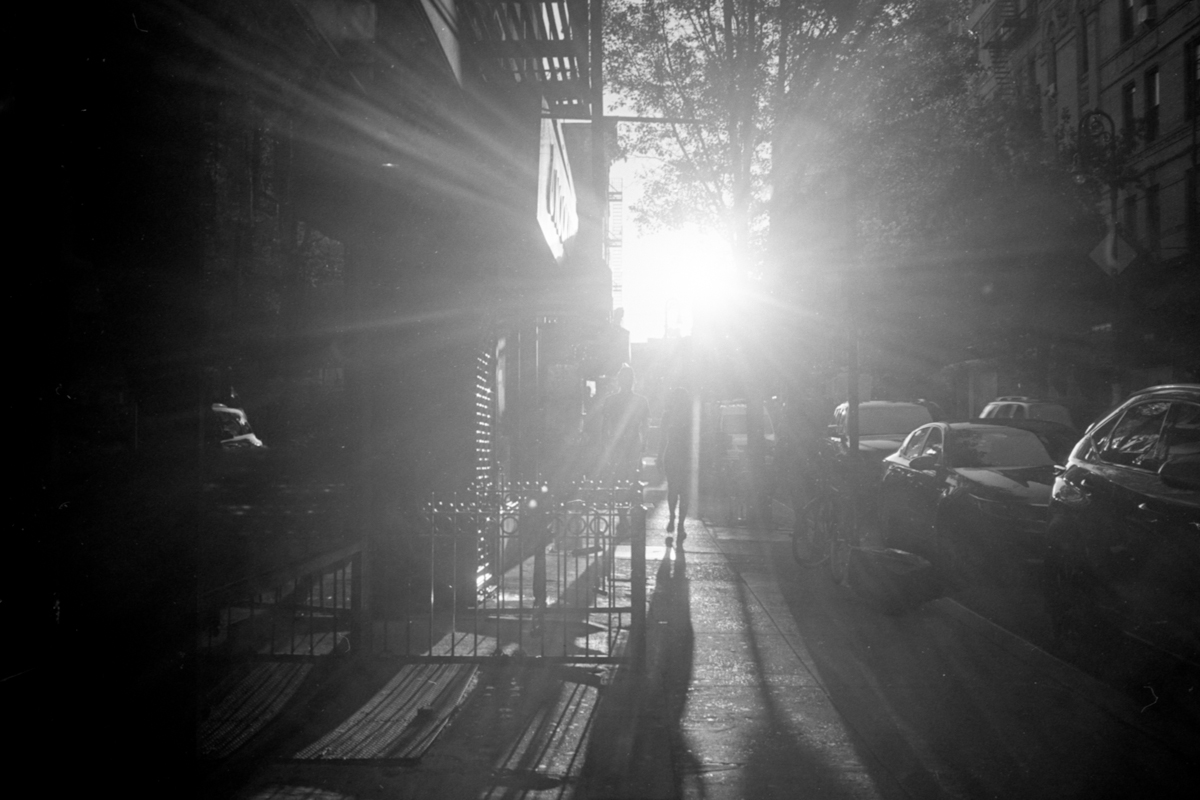

So of course this one I shot at +1.5EV to make up for shooting into the sun. Actually not that bad, and illustrates the lack of contrast (I pushed the contrast +20 in LR :( )

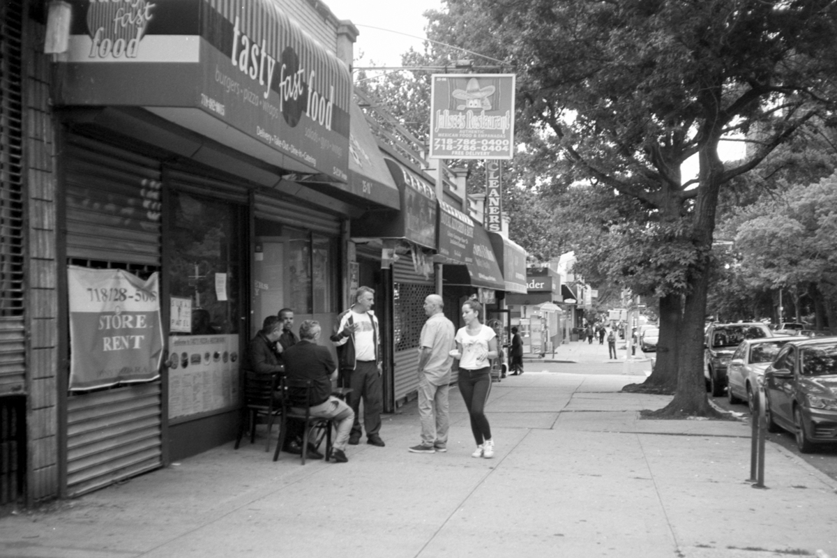

Street shot
